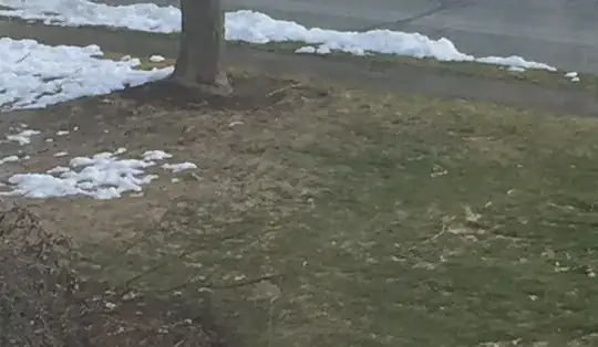

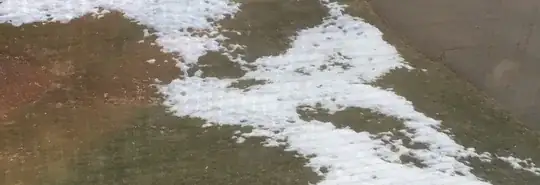

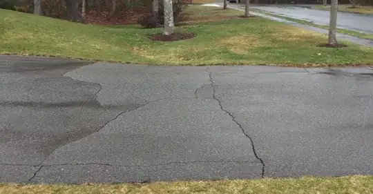

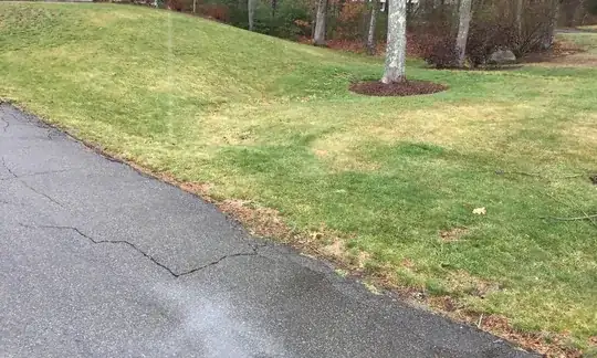

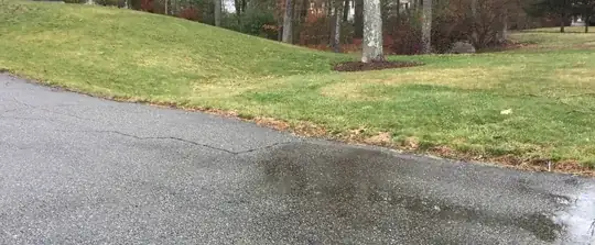

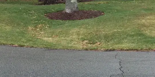

Update with pictures:
Debris pit area debris pit
Patchy lawn patchy lawn
More pictures of lawn lawn lawn lawn lawn

Truly not a bad program. BUT. It is a waste of time to core aerate until you've got a mature crop of grass. So cross that one off. The other thing that pops out is the excavation of the soil. The very top 4" is the soil you want to use. The subsoil is (NW) almost pure clay and to mix that up into your top soil would be asking for tons more work. I'd scrape 4-6" of the soil off the top FIRST and put it just outside the realm of your proposed lawn. I have a feeling that we've missed something translating your answer.
Please send pictures of the entire area. One of the things you want to do, the digging up and breaking up and excavating is contraindicated for clay soil and I KNOW the NW soils. They are very wet now and for quite awhile. Do not use machinery on wet clay soil. Do not use heavy machinery running around on this area. (go to other answers about lawns and clay soil).
Clay makes a fine lawn bed. Grading should take place when the 4-6" of top soil is very dry. I would bring in top soil instead of worrying about excavating. Grade by hand with 3' wide GRADING RAKES. Get a roller filled with water to compact. I know this sounds opposite of what I've just said but if you've got dry, friable top soil graded you have to compact to get air pockets out or you will have a roller coaster surface. Grade again, fill in holes and grade again. Do this before any rainfall. Forget fertilizing until you've got grass substantially growing.
I WOULD NOT seed. Go get sod and sod your lawn bed. Forget about any herbicide. Sod alone stops most weeds including crab grass. If you don't excavate and break up the weeds already there, the maintenance program I will outline will take care of any crabgrass. And deciduous weeds. Use the roller on your newly sodded lawn!
