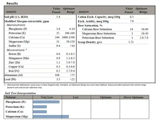

I recently used my local extension service to do a soil test. I did this before I fertilized for the spring so I got a post-winter reading on the soil. They said my lawn was very low in Phosphorous, Potassium, Calcium, and Magnesium:
  • Phosphorous: 1.8ppm, optimum range is 4-14ppm
  • Potassium: 25ppm, optimum range is 100-160ppm
  • Calcium: 244ppm, optimum range is 1000-1500ppm
  • Magnesium: 31ppm, optimum range is 50-120ppm

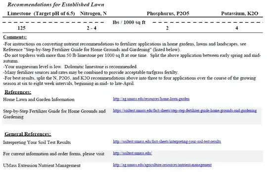

In their recommendations they said to add dolomitic limestone due to low magnesium. They also said to apply varying amounts of N-P-K to amend the other nutrients that were low. They recommended 2-4lb N per 1000sqtft, 2lb P per 1000sqtft, and 4lb K per 1000sqtft. I'm struggling with finding a great fertilizer that can add all of those nutrients in the right ratios (other than N, that's an easy one). Are there other ways to get more Phosphorous, Potassium and Calcium in my soil? Would the dolomitic limestone help any of those in addition to helping the low magnesium?
Images of the test results are below: results recos

The dolomitic limestone is limestone and thus has calcium. It's just that the "dolomitic" tag means it also has magnesium, so it should cover both of those needs, and that's likely factored into any suggested application rate they might have provided.
Don't stress too much about finding a fertilizer with the precise (given you have ranges, not so precise) ratio - you can use more than one to get what you need. So some 1-1-1, 5-5-5 or 10-10-10 up to the level of phosphorus you need and then either use 0-0-x and x-0-0 (or y-0-y) to fill in the N&K, unless you happen upon some 2-1-2, 1-1-2, 4-4-8, or 10-5-10 in your hunting.
How you get there is up to you - I'd reach for wood ash, granite dust or greensand for potassium (aka potash) and a little phosphorus. More phosphorous from steamed bonemeal, N, as you say, is easy.
If you'll be buying whatever, you might get Alfalfa Pellets (3-1-2) as less likely to interest dogs than bonemeal and not too far off the mark for what you need. Spread some greensand or granite dust to tweak it.
However, most recommendations are to spread the fertilizers at one point in time (such as spring) and the limestone at another (such as fall) rather than all at once.

Great job getting a soil test. What plants are you wanting to plant? Did that soil test give you your pH? Limestone will only raise the pH making other chemicals available to certain plants. This is just showing that you need to add chemicals to your soil for MOST plants. What you want to grow (blueberries? tomatoes? potatoes? need a more acid soil to be able to uptake the chemicals), and what the soil tilth is makes a huge difference in your choice of fertilizer. If you want to grow acid loving plants, this lime is not recommended.
Since this is for your lawn, you need to know the pH. Slightly alkaline (over 6.5) is necessary. Lime definitely is good for lawns IF your soil is below 7. Aeration is critical. I found that this ORGANIC lawn fertilizer (the one I used was Dr. Earth) was as different as night and day compared to fast release 'Scotts' or 'Ortho'. Worth every penny and lasts far longer than the synthetic stuff.
If this is your lawn, go find those la la organic fertilizers like Dr. Earth's Lawn Fertilizer. Doesn't matter the brand but look at the chemistry. I was blown away and I am a lawn 'expert' so to speak. And I am not so swayed by la la organic anything. Blown away!! Keep your grass mowed on HIGH no shorter than 3" if you have cool season grasses! I am not kidding!
What was the pH? They should have had that in the test.
