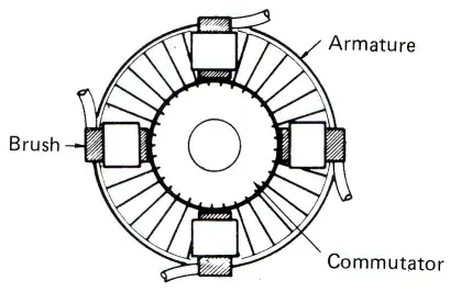

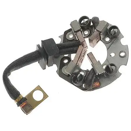

Likewise, the brushes inside the starter can suffer a similar fate. Since the brushes ride on the commutator, they wear out over time. Here are a couple of images of what they look like:
Usually in the its the commutator which will have a "bad spot" on it. This will cause the starter motor not to turn, because electricity cannot flow correctly. Banging on the starter can sometimes give enough of a jolt to the brushes where they will once again have the correct contact with the commutator and will allow electricity to flow.
