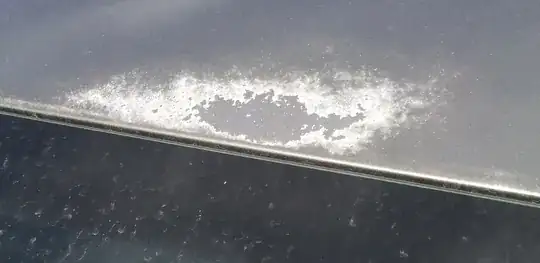

I have a 2006 Honda Civic, and the paint on the roof is beginning to deteriorate.
It looks as though maybe the top coat is discoloring and coming off, revealing the coat underneath, which seems to be intact. The affected area is currently about 7" x 2" (20cm x 5 cm) and seems to be slowly growing over time.
Honda seems to be aware of this problem and released a technical bulletin a couple of years ago, extending the paint warranty. Unfortunately this expired before I started to notice a problem on my vehicle. So if I am to fix this, it will be at my own expense.
So I am trying to determine:
  • Is this only a cosmetic problem, or is it more serious? (For instance, is it likely to lead to rusting of the sheet metal, or any structural problem?)
  • Is there any way to fix it short of repainting the entire roof? (I would probably have that done professionally.)
  • Assuming that, in the short term, I don't really care how the car looks, is there any advantage to fixing this in a timely manner? Might it be cheaper to fix it now than later? Or could I put it off indefinitely, until I want to sell the car, or until it looks so bad that I am embarrassed to be seen driving it?

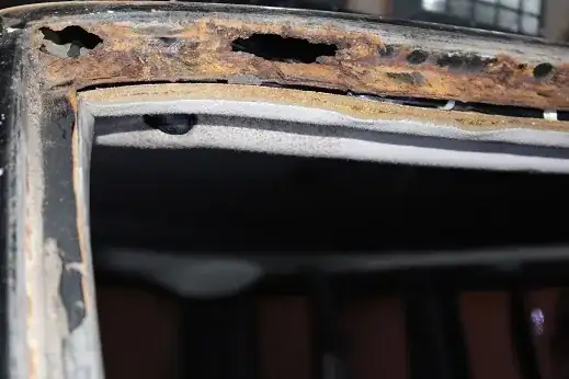

Others may not agree with me but I would not take this lightly. You have to consider where this deterioration has occurred. This is directly connected to your windshield. If you let this get to the next stage where rust is prevalent, there will be a number of issues to deal with.
  • Rusted windshield frame

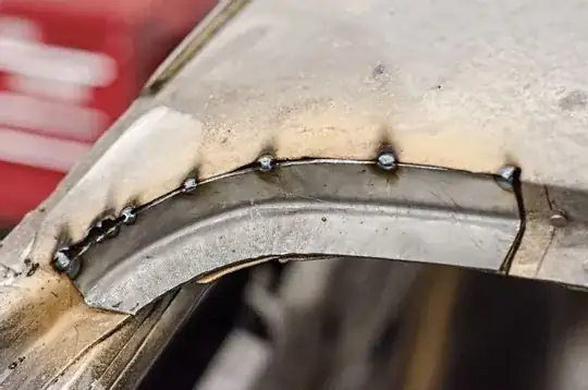

To get an idea of the work in solved to repair the channel, take a look at this. In severe cases you would be looking at a complete replacement.
  • Leaking windshield
  • Possible water damage
The cost to repair this will be drastically different from fixing this issue in its current state.

If the paint is metallic, then the top coat will be a clear lacquer. Other than not looking very nice, it shouldn't be a problem just leaving it. You could carefully flatten the lacquer with some fine wet and dry paper to remove the dull area where it is peeling off, then spray some clear lacquer on. Be careful not to rub through the paint, however.

From the pics i'm looking at it's clear coat coming off. This is what happens when the car sits in the sun for long periods of time, it's normal. A car that's exposed to the sun if your clear coat last five years your doing good. Two things you can do, take it to the body shop of your choice and get it painted or do nothing at this time it's not going to start rusting anytime soon. Under your clear coat is your color coat and under your color is primer, you will be fine for a while.

There is a cheap solution if you do not mind how the car looks in the short term. I would not recommend this for a long term solution, but if you want to put off having your car done professionally for abo a year, you can get a spray bomb clear coat for roughly 10 bucks a can. Make sure to scuff the paint lightly with 800-1000 grit sand paper so it sticks, and cover your windshield with masking tape & paper. Overspray is not fun.
*additional note: make sure to get all the peeling clearcoat off with the sandpaper.
