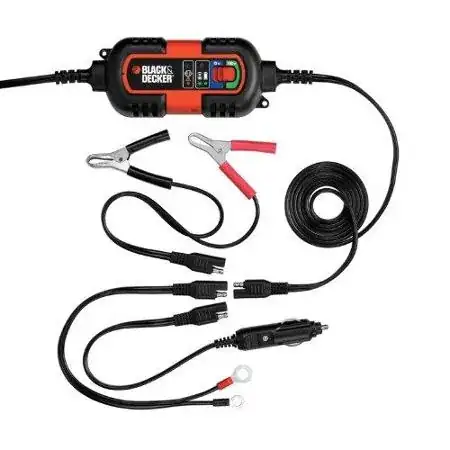

The "best" thing you can do is not use the crock clips on the battery while in the vehicle in the first place. Most trickle charges come with a permanently mounted set of leads, like you can see in this Black & Decker version:
In the picture you can see three different types of leads (as looked at from the standpoint of the common attachment lead):
  • Top: Crock clips
  • Middle: Permanently mounted leads
  • Bottom: Cigarette lighter
Using the permanently mounted leads provide you protection from several aspects. First, you can attach them to any point in the electrical system which provides a good ground (negative lead) and hot (positive lead). When attached to the charger, this will provide for the charging needs. Secondly, since the common attachment lead completely encloses when connected, there's no worry of an open spark occurring. If placed in an accessible place, you wouldn't even need to open the hood of a vehicle to get this attached.
You can use the crock clips directly on a battery which is not located in the vehicle. Use the cigarette lighter version for a quick attachment source. Use the permanently mounted ones for a quick disconnect under the hood without the need for fumbling with either of the other two.
