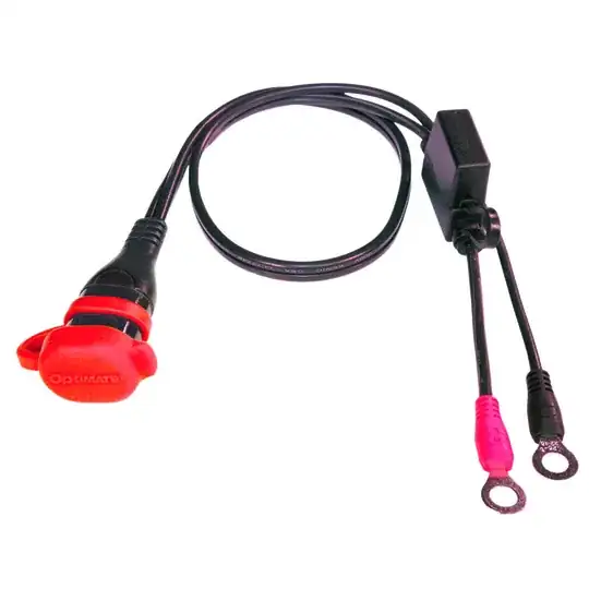

  • How about eyelets and connectors, like the one in the picture below? These can be attached to the negative and positive of the battery, so that, when you want to charge it, you just plug a cable to the connector. But isn't this the same as connecting a negative clip to the negative side of the battery? Or is this safer? If so, why?

The cable in your picture can be connected directly to the terminals, because it will not cause sparks, unless it's connected to the charger while you mount it.
