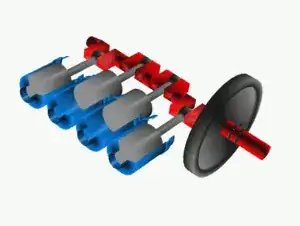

This is addition to Paulster's answer. Here's an animation
The disc in Grey is the flywheel
