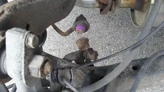

I have a 2006 Honda Civic and was changing my summer tires for winter tires. When removing the wheels I noticed behind 2 of the 4 wheels that what is shown in the middle of this picture was disconnected (in both of the passenger side wheel wells). The driver's side ones are connected.
What are these and what is the impact of this disconnection?
Behing wheel
The purple part can fit in the part in front of it.

I agree with @resident_heretic that these are the link arms for your stabilizer bars. The bar acts as a torsion spring that tends to keep the car level during cornering.
With the links broken on the passenger side I would expect you to notice a few things:
  1. More body roll during cornering,
  2. A possible loss of traction on the inside wheel in corners, and
  3. Possibly a knocking or rattling sound from the suspension as the disconnected parts bump into each other or into other parts of the suspension.
I found a YouTube Video of the replacement procedure, it looks to be a relatively straightforward process. The parts are sold individually (you can get just the passenger side link arms).
If you elect to do the repair yourself, look carefully at both sides (driver and passenger), for any signs of damage. The stabilizer bar and the links should be symmetrical, any unmatched bends would be a red flag and worth further investigation. The passenger side of the road (at least where I've lived) tends to be rougher, so it is possible that 10 years of driving has resulted in failure on just one side, but I'd still be on the lookout for any clues to the cause of the failure or related damage.

Looks like a stabilizer bar link. They come in pairs one on the left and one on the right side. They attach to the stabilizer bar. Stabilizer bars are part of a car's suspension system. They are sometimes also called anti-sway bars or anti-roll bars. Their purpose in life is to try to keep the car's body from "rolling" in a sharp turn.
