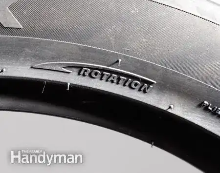

  • Noisy tires What brand and model of tires did they put on your car? Some tires are noisier than others. Also, some tires are what we call "directional," meaning they are designed to roll in one direction only. With your brand and model of tire, we can tell if it is a directional tire, but it would also say on the tire if they are, with an arrow and the word rotation printed on the sidewall of the tire. See the pictures below for 2 examples. If your tires are directional, for each tire, make little circles in the air with your finger in the direction the arrow says, and make sure that it is the same direction the tire would be rolling when you drive forwards. If it's not, they installed your tires backwards. They did this to my Mom a few years ago. enter image description hereenter image description here
