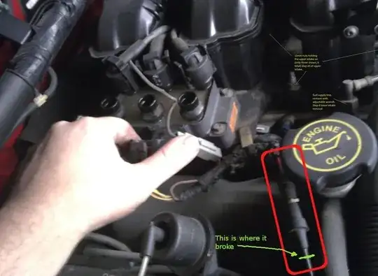

Unfortunately, during the change, I accidentally broke a little vacuum hose that goes to a small black globe towards the front. From what I have heard, this hose just controls things like the vents and such. I put some hose tape on it and drove it to work, planning on getting a replacement that day, and I barely made it there - after 10 minutes there was almost no acceleration, I had to pull over, wait 15-20 minutes, then go. The gas consumption was insane, like 5 miles per gallon.

Update: Forgot to put some pictures in here. This is the hose that broke, with the place of the break indicated:
BrokenHose

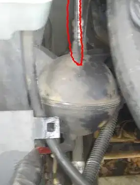

And here's a picture of where it attaches to this little vacuum globe thing:
Vacuum globe

Reset the ECU. It has learned to work in the conditions of a vacuum leak(busted vacuum line). From experience in working on my family's 01 v6 explorer sport, 91 bronco, and 2001 f150, the vacuum system is all one connected system. So, a broken vacu line can cause an overall vacuum issue. I don't know like with my jeep there is an ECU purge procedure,but generally disconnecting the negative terminal on the battery overnight or at least for a few hours will do the trick to purge the adaptive memory. Jeeps do a 50-warm up cycle learning period, don't know on fords. So, if it fixes your issue, give it a week or so before judging whether your issues are totally resolved or not. If it comes back again, replace all your plugs and wires. Newer fords seem very sensitive to vacuum leaks as my dad's v6 explorer sport was getting less than 10mpg and had poor acceleration as well until I reconnected the hose for the heater core coolant valve which was dry and popping off the fitting.

Have no idea about this particular globe thing... does not look like PCV of any kind... but I'm not sure.

Old thread I see but even so, It sounds like you lost vacuum to your fuel pressure regulator. Remember, the fuel pressure regulator reduces pressure to the injectors, and its lack of operation for whatever reason, turns plugs black, causes poor fuel economy, low rough idle, black puffs of smoke, - rich condition. It is a difficult fault to recognize.
