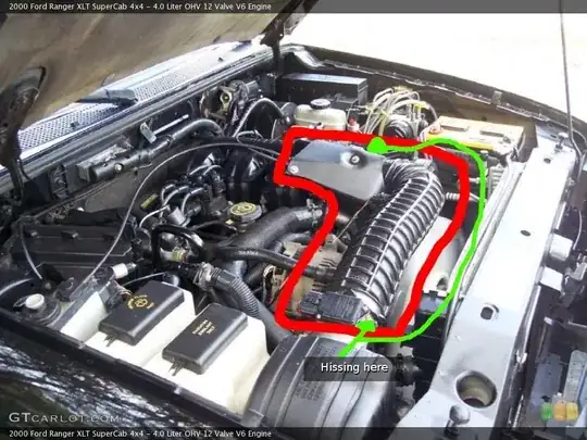

I'm guessing that most of these codes are caused by the same thing. I think that P1121, P0171 and P0174 are related to either a vacuum leak somewhere in the system or a bad ground. I've cleaned the throttle body and MAF to no avail. I put a hose in my ear and put it at various junctions along the air intake system, but there's always a fan running right there, making it very difficult for me to tell what's a leak and what's some airflow from that fan, but one thing I did notice is that I can hear some hissing at both ends of the large, ribbed hose that connects the throttle body to the mass air flow sensor (this is a picture I found and drew on, not one I took):
Hissing sound coming from the connection between MAF and TB.
I have tightened those connections and shimmied them forward and back to no avail. So the question is - what are the things that can cause this and what stop-gap measures can I take to fix it? Because of the nature of the problem, I don't want to go down any blind alleys, so any diagnostic tests you can recommend would be appreciated. My current thought is that the O2 sensor is a red herring and that the problem is a leak somewhere.

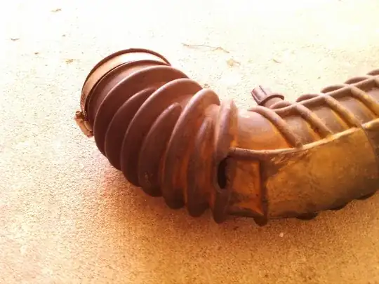

Update: There was indeed a leak in that hose (intake tube?), which I diagnosed by blowing smoke from a cigar into what I believe is one of the vacuum lines:
Hose in line

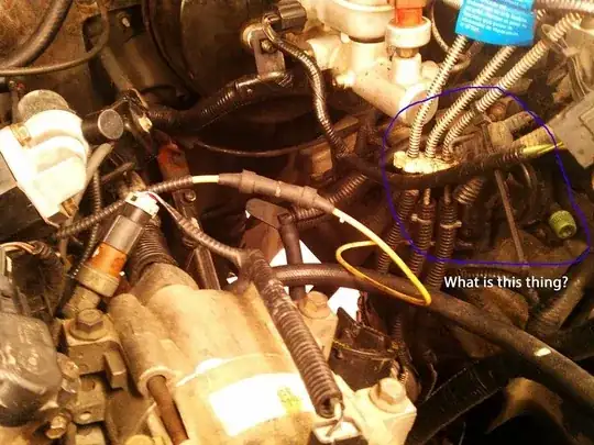

I made a quickie repair of the tube using tape and gum which seems to be holding just fine, but no power has returned, so evidently that's not the problem. Using the same cigar trick, I found smoke coming from some part I can't identify:
What is this thing?

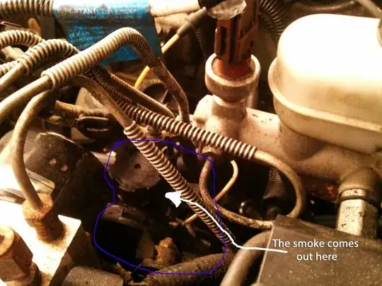

I'm hoping I'll be able to get this sorted soon. Here's another view of where the smoke actually comes out:
Update 2: Turns out that that it is actually the canister purge valve, which was indeed leaking (I unplugged the TPS and sprayed it with WD-40 and the idle noise changed, then swapped it with a new part and repeated and heard no change from spraying it). But for whatever reason that did not change the performance of the truck at all, so I'm still very much looking for any recommendations for possibilities for why I'm losing power, diagnostic tests I can run at home and how to just make this truck run for 1-2 weeks.

Also, I could never find even an OEM version of that intake hose running from the throttle body to the MAFS, so I ended up putting a bit of hose patch tape over the hole and covering the whole thing with quick-setting JB-weld and I've had zero problems since. Seems like it may work as a permanent fix (at least until I'm at a salvage yard one day and see the right part just sitting there).

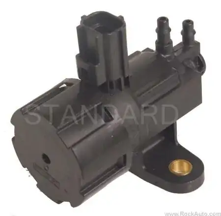

The part you're pointing to is this one.
EGR VACUUM SOLENOID Alternate/OEM Part Number(s): F57Z9J459C, F63Z9J459AA, ZZM32035A, ZZM42035A
EGRvacuumsolenoid2000ranger4.0l
