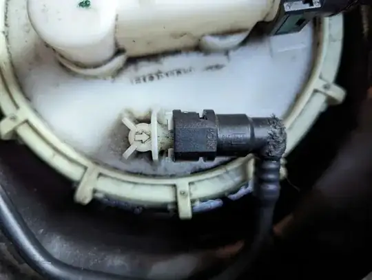

My 2013 Civic developed a pinhole leak on the high pressure fuel line where it attaches to the fuel pump.

It looks like the connector was rubbing against the housing which damaged it. I'm not sure how that could happen as the connector isn't close to the body. Perhaps a rock or other foreign material got lodged above the pump and it came out when I opened the cover. A comment indicated a rodent may have done this, that is defintely plausible.
pinhole leak
connected to pump

Something to think about before replacement is why did this occur in the first place. It looks to me as though it has been rubbing against the cover. Recognize what was going on there before you ever think about fixing this or you'll suffer the same fate going forward with the next fitting.

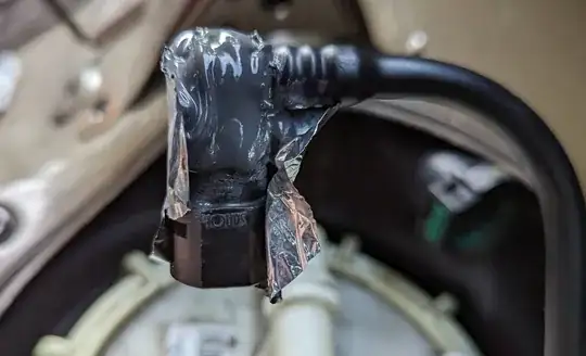

As a temporary fix, it was patched using JB Weld.

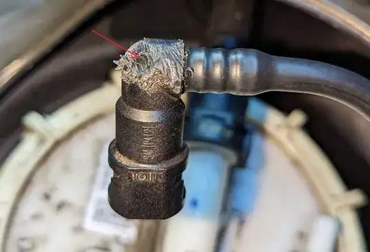

The site was roughed up with 100 grit sandpaper and cleaned with carb/choke cleaner.

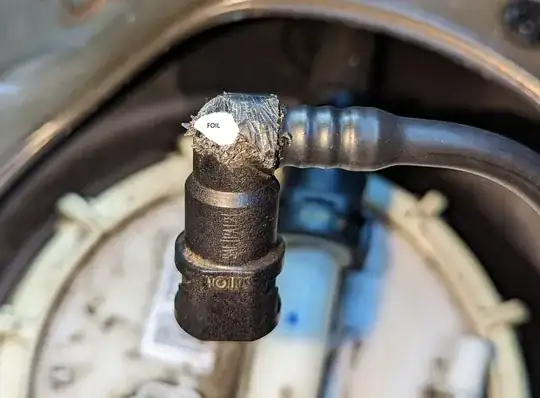

The pinhole was covered with a small piece of metal foil and pressed flat. Regular JB Weld (not Quik or Tankweld) is fairly thick, but will run, so I created a small tray underneath the connector out of foil.

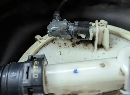

The entire connector was covered with a thick, even layer of JB Weld. The JB Weld wraps around the connector and extends past the pinhole on both side.
After letting it cure for 24 hours the fuel line was reconected. Turning the key to On without starting the car repressurized the fuel system and there were no leaks. It's been driven 20 miles or so as a test and no leaks so far.
The line will be replaced, I'll update this post if it leaks before then.
