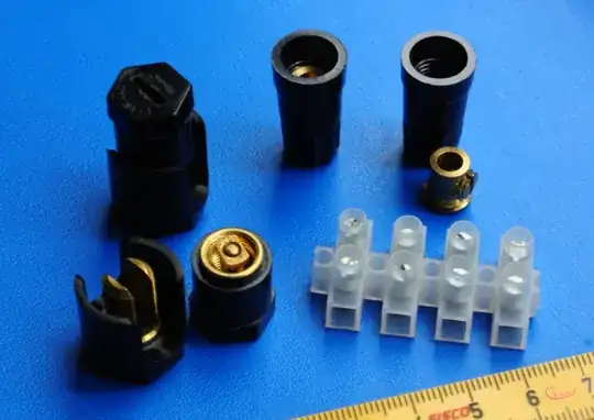

UK connectors
ruler is marked in cm with mm subdivisions
The white translucent screw-connector block in the foreground is a typical example. This one is rated for 5A. Other sizes are available for different current ratings.
An electrician left behind the other connectors in this picture. I suspect they were used for temporary connections during installation. I've not seen any in a completed installation (but I'm only a householder not an electrician, so have very limited experience)
The "Marr No.1" connectors at back right look superficially similar to US wire-nuts but are very different. The metal insert is removed and a grub nut is used to clamp the wires, then the plastic insulator is screwed over the connection.
The "Legrand 10mm2" connectors at top left may be for higher current ratings. Note that the plate that presses on the wires is arranged so as not to exert any twisting force on the conductors. Perhaps this avoids damaging stranded conductors. It certainly prevents the conductors being pressed to one side of the screw and therefore not being securely clamped in place.
An obvious advantage of these connectors is that the wires can be removed intact and should usually not need trimming before reconnection. I have the impression that in the US, wire-nut connections are often removed by cutting the wires, which may leave progressively less and less wire available in the junction-box or back-box for remaking connections.

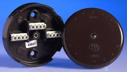

When more than two wires are to be joined, a slightly different type of screw-connector is used:
Example junction box

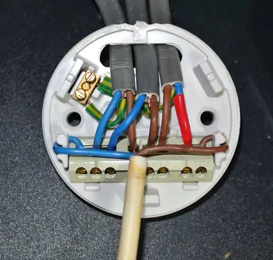

Switches, junction boxes and ceiling roses often contain sufficient bult in capacity that you don't need additional connectors:
Ceiling rose connectors

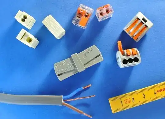

Easier-to-use connectors are becoming more common:
A variety of lever-action and squeeze-to-open connectors
Some of these are "lighting connectors" used to join solid-core wires to stranded wires. They are all rated at 20A and at least 300V. They all incorporate a test-port and wire-trimming guide.
It may be that UK electricians looking for novel connectors prefer these to twist-on connectors.

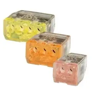

One possible reason provided by Ideal Industries in This article
Although very much the connector of choice in North America, the twist-on wire connector remains a largely untapped resource in the UK electrical market. Unfortunately many electricians still associate them with the poor-quality ‘screw-it’ wire nuts from the 1970s; manufactured from ceramic, these had a tendency to crack very easily and expose the wires, leading to safety hazards.
Though it looks like Ideal is still trying to tap UK twist-on wire connector market, with the new Twister® PRO (which to me looks just like a regular wire nut, aside from it being multicolored).
