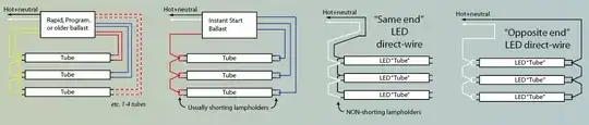

Instant-Start ballasts vs. other kinds
Instant-start ballasts are wired very differently. This requires some adjustment, notably in the lampholders.
Instant into a fixture wired for magnetic/rapid/programmed. In this case, you'll find 2 wires coming from each end of each lamp. Typically one pair of those wires is common to all lamps (usually yellow). You simply join the 2 wires to the single wire coming from the ballast.
Rapid/programmed/LED into a fixture wired for instant-start The rapid or programmed ballasts (or some direct-wire LEDs) need 2 wires to each end of the tube. The fixture, wired for an instant-start ballast, will have only one. The wires cannot be joined; both these wires will need to go to the lampholders. The problem is, they are likely to be shorting lampholders.
Shorting lampholders. Most tubes have 2 pins, so the lampholders have 2 pins. But instant-start ballasts use only one, and want them wired together. Fixtures built for instant-start ballasts often use an ugly beast called a "shorting lampholder", which shorts the two pins together internally. Watch out for these, they often have an "S" stamped on them, or only 2 holes when you'd expect 4. They won't work with rapid, magnetic, programmed or most direct-wire LEDs. Lampholders are mostly standard (mostly!) and you can buy common replacements online or from the big-box for under a buck each.

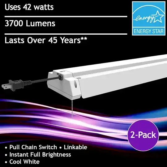

It depends on the update you seek. As mentioned in other answers, LED is at a point where it makes a lot of sense. I prefer LED fixtures over LED replacement bulbs when I have a choice - it removes some of the compromises that are made to make an LED light fit into the form-factor of an older bulb type.
For actual florescent tubes, an easy swap is T12 to T8 - the standard lamps are mostly the same lengths (unless you have an oddball, and then you have to hunt) and the pin fittings are the same, so you just need to choose a new ballast that works for your fixture (length/new wattage of tubes and number of tubes). If your fixture is old enough to have a "starter" you will follow the wiring digram in the new ballast and probably not use that. But T8 is not "the latest..."
Going to T5 as a bulb/ballast replacement is harder, since the tube lengths and pins don't match up, but weird converter/extended devices are made. Always pay attention to the question of whether you are spending more to convert than you'd spend to replace the fixture, though.
I would replace the fixture with the latest LED tube technology. For less than three times the cost of a replacement ballast you can have a flicker free, silent, instant on, ballast-less light with superior spectrum and light output.
