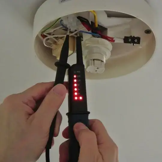

Here's how I used mine when replacing a ceiling light:
First, with the breaker on and the switch on, I test that my voltage-tester is working.
Good, it shows 230 volts as expected.
Now I turn the switch off and check the voltage again. At this point you'd expect no voltage.
But no, it is reading 50 volts! what does this mean?
As explained above, this is a phantom voltage. How can we be sure?

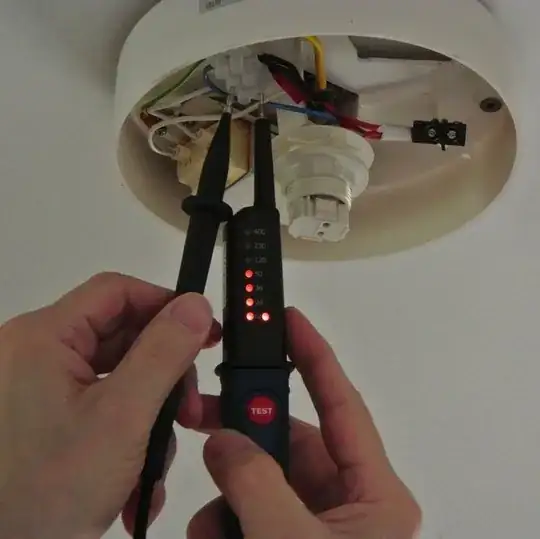

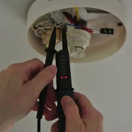

The tester has a button marked "test". This puts a lower resistance across the live connection and allows a small current to flow (only about 3 thousandths of an amp)
When pressing the test button, the 50V dissapears. That shows that this is a phantom voltage with no real power behind it.
I can now turn off the breaker, check my tester again elsewhere and proceed to work on the wiring in safety.
