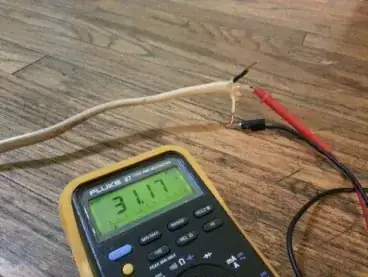

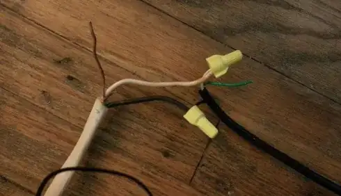

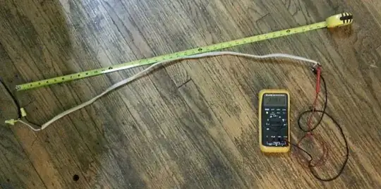

As an example, I've connected about 1 meter of NM 12/2 cable in a way similar to your situation. I connected neutral and line to the outside two conductors of the NM cable, and left the ground floating. I measured 31 V between neutral and the ground wire:
Overall setup
Source connections
Voltage measurement

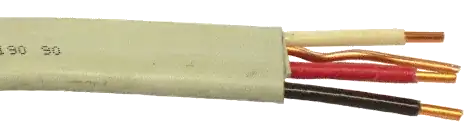

This calculation is based on assuming that your 12/3 cable looks something like:
Flat 12/3 cable
