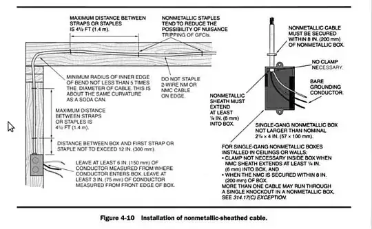

If you continue reading NEC 334.30 you'll come to subsection (B)...
334.30 Securing and Supporting Nonmetallic-sheathed cable shall be supported and secured by staples, cable ties, straps, hangers, or similar fittings designed and installed so as not to damage the cable, at intervals not exceeding 1.4 m (4 1⁄2 ft) and within 300 mm (12 in.) of every outlet box. junction box, cabinet, or fitting. Flat cables shall not be stapled on edge. Sections of cable protected from physical damage by raceway shall not be required to be secured within the raceway.
(A) Horizontal Runs Through Holes and Notches. In other than vertical runs, cables installed in accordance with 300.4 shall be considered to be supported and secured where such support does not exceed 1.4-m (4 1⁄2-ft) intervals and the nonmetallic-sheathed cable is securely fastened in place by an approved means within 300 mm (12 in.) of each box, cabinet, conduit body, or other nonmetallicsheathed cable termination.
FPN: See 314.17(C) for support where nonmetallic boxes are used
(B) Unsupported Cables. Nonmetallic-sheathed cable shall be permitted to be unsupported where the cable:
(1) Is fished between access points through concealed spaces in finished buildings or structures and supporting is impracticable.
(2) Is not more than 1.4 m (4 1 ⁄2 ft) from the last point of cable support to the point of connection to a luminaire or other piece of electrical equipment and the cable and point of connection are within an accessible ceiling
So if the structure is accessible, you must secure the cable. If you are fishing cable, you do not have to secure the cable. No trained mice with staplers required.

Yes. It will not pass code without them.
NEC 334.30 and 314.17 Type NM (nonmetallic) cable shall be secured at intervals not exceeding 4.5 feet and within 12 inches of each box. When a single gang box 2-1/4” x 4” or smaller is used without a cable clamp, the cable shall be secured within 8” measured along the sheath.
