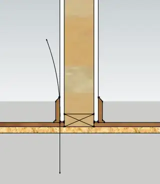

I have a raised crawlspace (4 feet high or more). I need to get the cables from behind the wall into the crawlspace. It looks like many people drill a hole through the sill plate and then route the cables through the hole. Is this recommended, or does it cause any structural issues? I would be drilling the hole from the crawlspace up into the wall. From the room above, I would then need to cut a hole through the plaster. Is there a way to make these two holes line up?

  3. Chuck an insulation hanger wire in a drill, like a drill bit. Drill a tiny hole in the floor, right up against the baseboard (or behind the baseboard). Unchuck the wire, leave the hanger in the floor for now.
  1. Have an assistant pluck the hanger from above, while I crawl underneath with a drill, fish tape, electrical tape, staple gun, and flashlight. I follow the sound of the plucked wire hanger.
  2. Drill a hole through the sill plate, using the hanger as a reference, e.g. "2 inches towards the front door".
