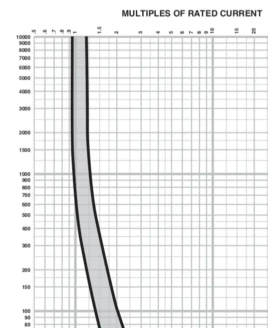

Your usage scenario is quite typical, and whether your 15A breaker will trip or not depends on how long you are cutting, how heavily the saw is mechanically loaded, and the magnetic & thermal trip characteristics of your breaker.
Let's say you have the lights on and you are doing some heavy cutting. You are past the inrush (startup) and the motor is not stalled.
Here's a sample calculation for your nominal cutting conditions:
  1. The motor for a dewalt 7480 is spec'ed at 1850W or 15.4A at 120V, with maximum load before stall.
  2. Your lighting is 4 40W LED panel lights, 1.3A.
  3. Total current 16.8A
  4. Cutting Time 100s
  5. From the "trip curve", a "Square D" will definitely trip at 2x the rated current, i.e. 2x15A = 30A. And definitely not trip at 1.2x rated, i.e. 1.2 x 15A = 18A
  6. The total is just below the "definitely not" trip point. Turn down your garage stereo.
  7. Happy cutting.
Load time (seconds) vs Maximum current as a factor of the rated (e.g. 15A) current. To the left of the grey band: definitely not trip, below thermal trip. To the right of the grey band: definitely will trip, above magnetic trip.
Breaker trip chart from https://download.schneider-electric.com/files?p_enDocType=Data+Bulletin&p_File_Name=0600DB0105.pdf&p_Doc_Ref=0600DB0105
