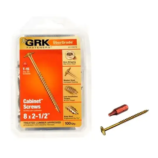

1) For connecting face frames use 2-1/2" or so #8 wood screws. Pre-drill the holes with a counter sink bit. Best way to hide them is to place them where the hinge hardware will cover them up.
2) For securing the cabinets to the wall use cabinet screws with a nice washer head, not drywall screws. If you need to attach a cabinet to a side wall or adjacent cabinet, just attached some spacers to the wall made of 2x4s and plywood to get the correct thickness, then attach the cabinet to that. This is useful in the case of having no studs behind a narrow cabinet.
Washer Head Cabinet Screw: enter image description here
