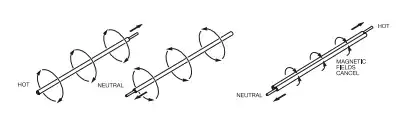

The hot and neutral wires should be in the same raceway to reduce Inductive Coupling. You'll see using the Right-hand rule, that the magnetic fields created by the hot and neutral wires tend to cancel each other out. Thereby reducing the affects of inductive coupling.
enter image description here I = current flow direction. B = direction of the magnetic field.
