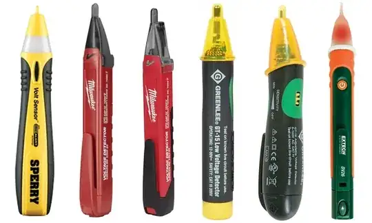

The paranoid way to use a non contact voltage tester is:
  • Test that outlet shows as live
  • Flip breaker
  • test that outlet shows as dead
  • Test a different outlet that should still be live
The last step is what would have saved you a shock here - its to check that your tester didn't die while you were flipping the breaker, and that you haven't done anything silly like forgetting to turn it on.
Though if it were a loose connection you still could be very unlucky and have it pass all those tests with the outlet still live.

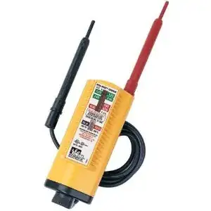

Always test the tester. (Preferably with a different tester.) NCV's should only be used to confirm an outlet should work, NOT that it is dead. They are also nice for locating CBs if you want to play the flip on/off game, though not to be used for confirmation of that either. Item 4, the outlet tester, would have alerted you to the live wire and it's incorrect wiring. It's a common courtesy in my crew to ask "Did you check it with a wiggy yet?" (item 2) for their own safety as they begin. We also never defer to each other, check it again yourself.
Once I have a box open I check all around with a NCV again. Most likely there are other wires from other circuits and depending on the situation those get shut-off too.
A note on NCVs:
They will sometimes pick up a strong enough induced current (from proximity to live wires) to give you a false positive. Again, non-contact voltage testers are best used to see if an outlet should be working, at a glance, NOT to confirm that it is dead.
