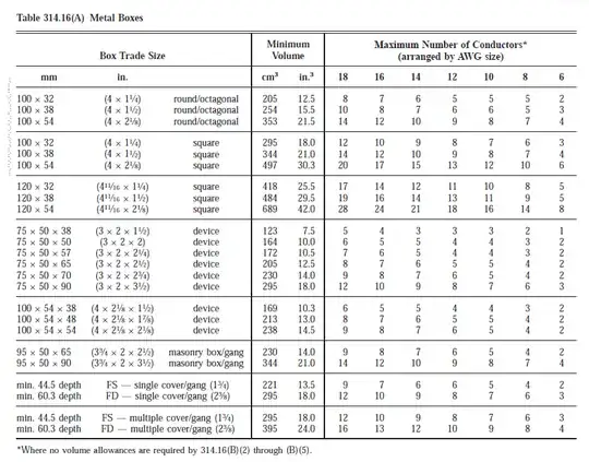

Conductor box fill
If you're working with standard sized boxes, you can use Table 314.16(A) to determine the number of conductors allowed in a box.
Table 314.16(A)

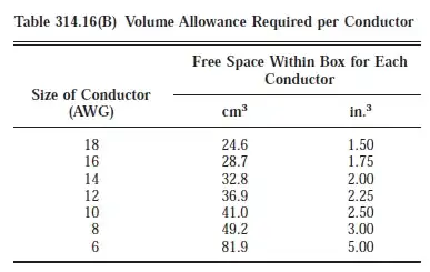

Use this Table 314.16(B) to calculate the total box fill.
Table 314.16(B)
  • Sum up the count from the Conductor Fill section, and multiply by the value from the table. For example: If you had 4, 14 AWG conductors, you'd multiply 4 by 2.00.
  • Sum up the counts from the Clamp Fill, Support Fittings Fill, Device or Equipment Fill, and Equipment Grounding Conductor Fill sections, and multiply by the value from the table of the largest conductor in the box. For example: If this value was 4, and the largest conductor in the box was 12 AWG. You'd multiply 4 by 2.25.
  • Add the 2 totals together. For example: Using our values above (4 x 2.00 + 4 x 2.25 = 17), you'd need a box with a volume of 17 in. cubed.

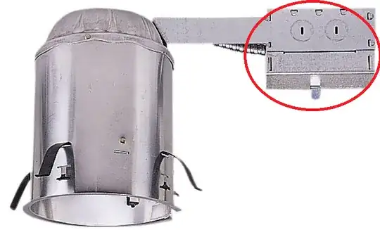

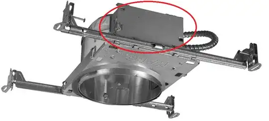

Modern recessed lights have junction boxes built in.
Similarly on a new work recessed fixture
You are free to daisy-chain other lights or receptacles, so long as you connect properly and do not exceed the number of wires for the size of the built in box. A chart to calculate this can be found here.
