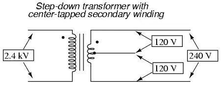

In a 120/240V single split phase system, the two ungrounded (hot) legs are actually connected to the secondary winding of the distribution transformer. The transformer actually steps down the voltage to 240 volts, so the two legs are a complete 240 volt circuit.
The grounded (neutral) conductor is connected to the center of the coil (center tap), which is why it provides half the voltage.
split phase transformer
Therefore, if a device requires only 240V, only two ungrounded (hot) conductors are required to supply the device. If a device runs on 120V, one ungrounded (hot) conductor and one grounded (neutral) conductor are needed. If a device needs both 120V and 240V, then two ungrounded (hot) conductors and one grounded (neutral) conductor must be used.

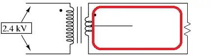

If you connect a load between the two ungrounded legs of the circuit, you can see how you have a complete circuit through the coil.
240V complete circuit

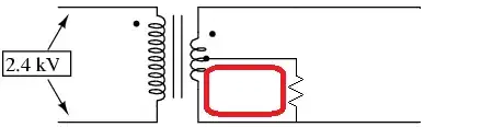

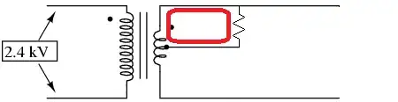

If you connect a load between one of the ungrounded conductors, and the grounded (neutral) conductor. You can also get a complete circuit, though it's only through half of the coil.
120V complete circuit
